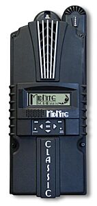

The MidNite Solar Classic MPPT charge controller is the most advanced controller on the market. It comes in three standard models (150, 200 and 250 volts) which will charge up to 72 volt battery banks using solar, wind or hydro power. The model number corresponds to the maximum operating voltage that the controller can handle on the input side. The Classic is also the safest controller available due to its built-in ground fault and arc fault protection. No other controller offers the built-in arc fault protection. This means that the MidNite Classic is the only controller that fully complies with the 2011 National Electric Code regulations without having to add additional equipment to your system. Not only is the Classic the safest, but it's also one of the easiest to set up and use. MidNite Solar has taken the guesswork out of setting up your system by implementing a set up wizard with voice prompts. The wizard can help walk you through battery hook up, PV array sizing and hook up, wind turbine program selection, wire sizing, breaker selection, PV combiner selection, sunrise and sunset program set up and voltage drop calculations. Take a look at this chart to see how the Classic compares to the competition.

Model Number 150 200 250
Operating Volts Input 150VDC 200VDC 250VDC
Battery Charge Volts 12-93 Volts 12-93 Volts 12-93 Volts
Max Current Output
at 25°C (77°F)
96A @ 12V 74A @ 12V 60A @ 12V
94A @ 24V 70A @ 24V 62A @ 24V
83A @ 48V 65A @ 48V 55A @ 48V
De-rated Current
at 40°C (104°F)
80 Amps 66 Amps 52 Amps
Environment -40°C to 40°C (-40°F to 104°F)
Physical Dimensions 14.87" x 5.95" x 4.00" (378mm x 151mm x 102mm)
Ship Weight 11.5 pounds
