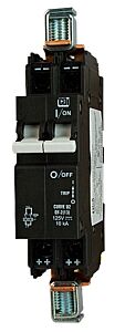

MidNite Solar 80A and 100A PV Array DC Breakers
Midnite Solar MNEPV 80 Amp and 100 Amp, 150 volt DC circuit breakers for array combiners and other DC applications. These are most commonly used in array combiners, but are suitable for any DC circuit up to 150 volts, such as DC distribution and small inverters. They mount on any standard 35mm DIN rail.
All MidNite circuit breakers hold 100% rated current independent of ambient temperature.
For E-Panels, MNDC, Combiners and Baby Box. These are standard DIN rail mount, and fit nearly all array combiners, including Outback Power and Midnite Solar. These breakers are NOT listed for AC circuits. DC only.
Available in 80 Amp or 100 Amp models.
10,000 AIC (Ampere Interrupt Capacity)
Max wire size: #2 AWG stranded
Circuit breaker is 1" wide and will take up two slots in array combiners and enclosures.
