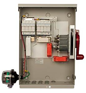

MidNite Solar MNPV8HV-Disco 3R Disconnecting Combiner
MNPV8HV-Disco 3R
$937.50
MidNite Solar MNPV8HV Disco Combiner
Click on the details tab to see a video about the MNPV8HV disconnecting combiner.
NEMA 3R aluminum enclosure (no rust, won't turn to dust). 5 poles, 80 or 160 amp busbars depending on how they are configured, 100 or 200 amp switch depending on configuration. The disconnect has a built in shunt trip with positive feedback. Optional PV connected power supply, optional AC connected power supply for redundancy, 90° C terminals, see through deadfront, color coded busbar guards, fuseholders, 15 amp fuses, strain relief connectors, hole plugs and MNSPD600 surge protection device included. Works with the Birdhouse emergency disconnect switch and meets 2011 NEC.
Dimensions: 24" x 19" x 6"
Weight: 16 pounds
SKUMNPV8HV-Disco 3R
