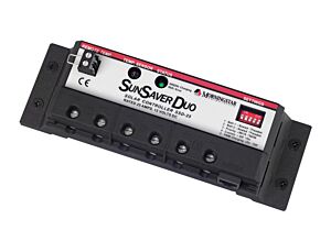

Morningstar SunSaver Duo 25 Amps 12 Volts
SunSaver dual 25 amp solar electric charge controller. Charge two batteries or battery banks from one single PV array. This is a great setup for RV's or any other setup that has 2 sets of batteries to keep charged up. Morningstar's SunSaver Duo is an advanced PWM two battery controller for RV's, caravans, boats and cottages. This product will charge two separate and isolated batteries at the same time, such as a "house" and an engine battery, based on user selectable priorities. The SunSaver Duo employs Morningstar's legendary SunSaver controller technology, whose long-term track record for high reliability and improved battery charging is well-recognized in the solar industry. The SunSaver Duo is epoxy encapsulated for environmental protection, is user adjustable via DIP switch or connection to a personal computer, and has an optional remote temperature sensor.
| Rated Solar Input | 25 Amps |
| Battery Voltage | 12 Volts |
| Maximum Solar Voltage | 30 Volts |
| Regulation Voltge | Sealed Battery: 14.1 Volts |
| Flooded Battery: 14.4 Volts | |
| Float Voltage | 13.7 Volts |
| Equalization Voltage | 14.8 Volts |
| Largest Wire | #6 AGW |
| Dimensions | 6.7" x 2.2" x 1.6" |
| Weight | 0.57 lbs. |
