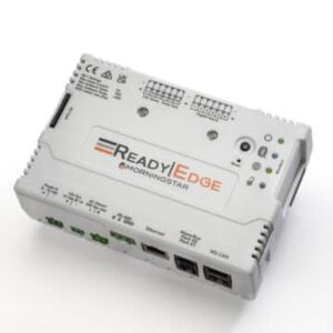

The Morningstar ReadyEdge RE-1 is a powerful all-in-one energy management device designed specifically for off-grid and hybrid solar systems. Built with integrated software and advanced communication features, it provides system-wide measurement, monitoring, and control without the need for external add-ons.
With native support for SNMP and Modbus protocols, plus optional cloud connectivity via Morningstar Solar Connect, ReadyEdge delivers real-time data collection and remote system visibility. It supports up to 16 Morningstar charge controllers and inverters, aggregating performance metrics into the LiveView 2.0 dashboard for local monitoring or remote access.
More than just a monitoring tool, the RE-1 intelligently manages auxiliary charging sources—including generators, fuel cells, and AC chargers—making it essential for maintaining reliability in hybrid solar systems. Compact and purpose-built for solar applications, ReadyEdge simplifies system integration while providing complete control over energy generation and storage.
Key Features and Benefits:
  • Comprehensive Data Collection: Plug-and-play interoperability with Morningstar controllers, inverters, and other devices makes it simple to consolidate system information.
  • Battery Health & insights: Track voltage, energy balance, and precise state of charge with the integrated battery meter—or connect directly with select battery BMS for detailed real-time health metrics and performance history.
  • Intelligent Monitoring & Alerts: Detect changes on analog and digital inputs and set user-defined conditions to receive alerts before issues escalate.
  • Generator & Auxiliary Source Management: The built-in AGS feature simplifies generator control with quick-start templates, while advanced users can configure conditional logic for complex charging scenarios.
  • Accessible Anywhere: View system performance locally via the LiveView 2.0 or remotely through Morningstar Solar Connect. Open protocols (MODBUS™, MODBUS TCP/IP, SNMP) ensure seamless integration with existing networks.
