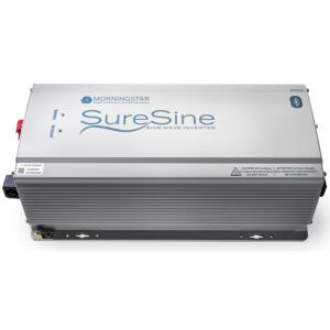

Morningstar SureSine 1250W 48V Inverter With Hard-Wired Output
This new SureSine line has:
  • Wireless Android and iOS utility apps for set-up and monitoring with remote devices, plus Bluetooth communications.
  • Multiple AC hardwire remote terminal options on selected models.
  • Industry leading safety, low-noise and high performance NRTL certifications for reliability and system conformance.
  • Superior thermal performance with fanless design means higher reliability– for example, the 300W model doesn’t derate until 45 C and delivers 200W at 60 C. The small 150W model doesn’t derate even at 60 C! That’s outstanding performance in their power classes.
  • Full communications capabilities include: RS485, USB, Ethernet, MS-CAN, Bluetooth while using industry-standard MODBUS protocol.
SureSine SI-1250-48-120-60-HW Specifications:
  • Rated Battery Voltage: 48 Volts DC
  • Continuous Power @ 77°F: 1250 Watts
  • Peak Efficiency: 94%
  • Output Voltage: 120 Volts AC +/-5%
  • Output Connection: Hard-Wired Terminals (no receptacle)
  • Output Frequency: 60 Hz
  • Waveform: Pure Sine Wave
  • Cooling: Fanless Natural Convection
  • IP Rating: IP20
  • Weight: 29.3 lbs (13.3 Kg)
  • Dimensions: 20.6" x 9.7" x 6.1" in (524 x 247 x 156 mm)
  • Wired Communications: RS485, USB, Ethernet, MS-CAN
  • Wireless Communications: Bluetooth, Android and iOS Apps
  • Warranty: 5 Years
