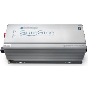

Morningstar SureSine SI-2500-48-120-60-HW 2500W 48V Inverter With Hard-Wired Output
Morningstar SureSine 2500W 48V Inverter With Hard-Wired Output
This new SureSine line has:
- Wireless Android and iOS utility apps for set-up and monitoring with remote devices, plus Bluetooth communications.
- Multiple AC hardwire remote terminal options on selected models.
- Industry leading safety, low-noise and high performance NRTL certifications for reliability and system conformance.
- Superior thermal performance with fanless design means higher reliability– for example, the 300W model doesn’t derate until 45 C and delivers 200W at 60 C. The small 150W model doesn’t derate even at 60 C! That’s outstanding performance in their power classes.
- Full communications capabilities include: RS485, USB, Ethernet, MS-CAN, Bluetooth while using industry-standard MODBUS protocol.
SureSine SI-2500-48-120-60-HW Specifications:
- Rated Battery Voltage: 48 Volts DC
- Continuous Power @ 77°F: 2500 Watts
- Peak Efficiency: 95%
- Output Voltage: 120 Volts AC +/-5%
- Output Connection: Hard-Wired Terminals (no receptacle)
- Output Frequency: 60 Hz
- Waveform: Pure Sine Wave
- Cooling: Fanless Natural Convection
- IP Rating: IP20
- Weight: 48.7 lbs (22.1 Kg)
- Dimensions: 21.4" x 9.7" x 6.1" in (544 x 247 x 156 mm)
- Wired Communications: RS485, USB, Ethernet, MS-CAN
- Wireless Communications: Bluetooth, Android and iOS Apps
- Warranty: 5 Years
| SKU | SI-2500-48-120-60-HW |
