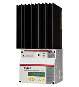

Morningstar TS-MPPT-60M TriStar 60 Amp MPPT Solar Charge Controller w/Meter
NOTE: This controller comes with a battery temperature sensor included.
NOTE: This model TS-MPPT-60M is the same as the standard 60 Amp model, except it also comes with the TS-M2 digital meter pre-installed on the unit.
Click here to see how the Morningstar TS-MPPT-60 compares to similar MPPT charge controllers.
The TriStar MPPT solar controller with TrakStar Technology™ is the world's most advanced maximum power point tracking photovoltaic (PV) controller providing many advantages over comparable products:
  • Maximizes solar energy harvest
  • Highest peak efficiency of 99%
  • Includes on-board Ethernet
  • Provides up to 200 days of data logging
  • Meets FCC Class B Part 15 specifications for electronic noise
  • Comes with a remote battery temperature sensor
The TriStar TS-60M MPPT is designed for off-grid PV systems as large as 3.0 kWp, and is rated for 60 amps at up to 150 volts PV open circuit. This product is extremely reliable since it has a robust thermal design, no internal cooling fan and no mechanical relays.
The TriStar MPPT is well suited for large professional and consumer PV applications such as remote telecommunications and off-grid homes.
The 60A version of Morningstar's TriStar MPPT features a built in Ethernet port for remote data monitoring, programmability and alert notification. Another feature of its communications abilities is that it has an internal web server that allows any compatible web browser to connect to it and display current system operating status, network setup page and the internal logged data values of the controller.
