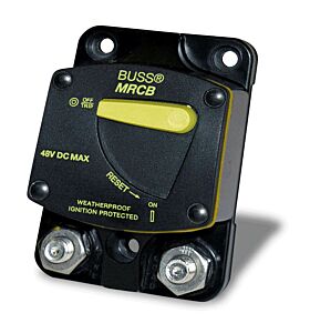

MRCB 187200F-03-1 200 Amp DC Circuit Breaker with Switch
187200F-03-1
$80.63
200 Amps DC
48 Volts DC (not for 48V systems)
Marine rated
Bussmann 187 Series Marine Rated Circuit Breaker with Manual Switch, 200 Amp
Note: These breakers are rated for a maximum of 48 volts DC. However, they are not to be used on a 48 volt system because the system voltage will actually rise above 48 volts. The maximum system voltage we recommend using with these breakers is 36 volts DC. If you have any questions about which breaker is best suited for your system or equipment, please call us or email us.
Current rating: 200 Amps DC @ 48V DC max.
These 12 to 48 volt DC rated circuit breakers are useful for a variety of purposes in DC power systems. We sell them mainly for use with small inverters in the 150 to 1000 watt range, where the Class-t fuses might have too high an amperage rating. The on-off switch function makes them ideal where you may want to turn the inverter off when not in use to save battery power. Surface mount, panel mount versions available on special order. These are available in a range of sizes, from 30 to 200 amps. The 200 Amp breaker is suitable for inverters around 1,400 to 1,500 Watts, depending on maximum surge.
