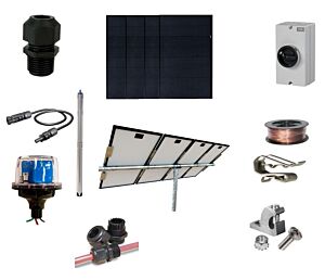

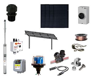

The Sun Pump HR 12-328 Solar Water Pumping Kit is a reliable and high-efficiency solution for off-grid water delivery. Designed for remote applications, this system harnesses direct solar power from (4) 445W Canadian Solar CS6.2-48TM-445H solar panels to operate the Sun Pump HR 12-328 helical rotor submersible pump, offering exceptional daily water output in full sun conditions.
Mounting is simplified with a Tamarack top-of-pole mount configuration. Offering flexible deployment for remote or rural installations. Whether for livestock watering, irrigation, or household supply, this kit offers dependable solar water pumping with no fuel costs or emissions.
If customization is needed, for example where a pressure system is required, please contact our engineering team for design assistance, we can put a solar pumping system together for nearly all applications.
Pump Details:
- Maximum Head: 328 ft.
- Maximum Flow Rate: 12 GPM
- Pump input range: 120-400 VDC or 120-265 VAC
- Four - CS6.2-48TM-445H 445 Watt Solar Module
- Ten - MC-Clips
- One - UNI-PGRM/4P2-47
- One - MC4-30-MF-1kV Extender cable
- Five - GBL4-DBT
- Thirty - BARE-6
- One - SI16-PEL64R-2
- One - MNSPD-300-DC
- One - MNSR-1000
- One - 1/2" Liquid Tight Connector Kit
- One - HR 12-328 AC/DC
- One - HR Control Module Sun Pump
