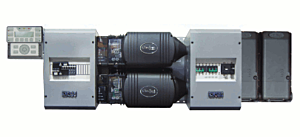

Outback Power FLEXpower FP2 VFXR3524A-300 Pre-Wired Inverter System
NOTE: This system incorporates the new VFXR3524A-01 model inverter which replaced the VFXR3524A. It's the same inverter but also conforms to the new UL 1741 SA as defined in California's Rule 21. This inverter qualifies to be installed anywhere in the United States, including California and Hawaii. You can read more about this in the OutBack Power Product Change Notice.
The Outback FLEXpower TWO system comes fully assembled and tested from the Outback factory. The units are built to meet National Electric Code (NEC) standards and designed for ease of installation. FLEXpower FXR systems can be used for both off-grid and grid-tie configurations. The systems have been outfitted with all the necessary wiring, circuit breakers, communications, battery monitoring and PV ground fault protection. All equipment is ETL listed. The FLEXpower TWO FX-R Series is perfect for nearly any type of application: residential and commercial applications including cabins, vacation homes, farm buildings, remote communications sites and back-up power systems, with all necessary components integrated into a compact hang-on-the-wall system with a minimal footprint. The FLEXpower systems are designed for fast installation which cuts down on time and cost. The system comes with a mounting bracket that attaches to your wall, which then allows you to hang the FLEXpower system. This allows you to get up and running very quickly; simply connect the PV input, AC output, and battery connection.
  • 7,000 Watts
  • 24 Volts DC
  • Two VFXR3524A-01 Pure Sine Wave Inverters with Advanced Charging
  • 250 Amp DC Inverter Breakers/Disconnects
  • FLEXnet DC Battery Monitor
  • Two FLEXmax 100 Amp Charge Controllers With Remote Temp. Sensor
  • FLEXware Surge Protector
  • 120VAC Bypass Assembly
  • Weight: 256
