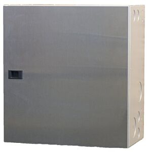

Outback GSLC-PV-300VDC Load Center for Two Charge Controllers
The Outback Load Center is designed to work with the Radian series inverter. It comes with inverter bus bars, negative terminal bus bars (TBB), ground TBB, Neutral TBB, PV (positive) TBBs and three shunts. It also has space for AC and DC circuit breakers. The GSLC has mounting holes that will accommodate the HUB communications manager and up to two FLEXmax charge controllers (picture #2). This model comes prewired from the factory and also includes the AC TBBs, AC circuit breakers, bypass interlock, main inverter disconnects (175ADC breakers), PV input disconnects, shunt bus, FLEXnet-DC battery monitor.
  • Inverter Negative DC Bus Bars
  • Inverter Positive DC bus Bars
  • DC Positive Bus Plate
  • Negative Terminal Bus Bar
  • Ground Terminal Bus Bar
  • Neutral Terminal Bus Bar
  • PV Positive Terminal Bus Bar
  • Main Inverter Disconnects
  • AC Circuit Breakers
  • Maintenance Bypass Interlock
  • AC Terminal Bus Bars For Inverter Output, Grid and Generator
  • 3 Shunts and Shunt Bus
  • PV Input Disconnects
  • FLEXnet-DC Battery Monitoring System
  • Rated For Indoor Use Only
  • Knockouts For 1/2", 3/4", 1", 1.25", 1.5" and 2" Conduit
  • Weight: 40 lbs.
  • 17"H x 16"W x 8.5"D
