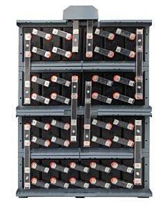

The EnergyCell XLC battery system is an ideal solution for today's demanding off-grid, self-consumption or backup applications requiring larger energy storage. The EnergyCell XLC battery system incorporates time-saving modular design. The integrated cabinet with a XLC provides a cost effective solution for all users saving over 40% of installation time compared to a traditional rack. Proven lead-acid VRLA technology, combined with enhanced carbon additives, make it one of the safest batteries in the market. The EnergyCell XLC is unparalleled in performance backed up by a 10-year full replacement warranty.
The XLC’s pioneering lead-acid technology incorporates an added carbon additive to the negative active material (NAM), enhanced separators and anti-corrosion grid design delivering a dramatic improvement in service life. 3800 cycles at 50% DoD, 17 year standby life. Optimized to operate seamlessly with OutBack Power conversion equipment and OPTICSRE connectivity with real-time access to critical battery performance data.
1000XLC Specifications:
  • Norminal Voltage Per Cell: 2 VDC
  • Toltal Voltage: 48 VDC
  • Optimal Temperature Range: 77oF
  • Float Voltagel: 53 to 54 VDC
  • Maximum Charging Current: 300 ADC
  • Terminal Hardware: M10 Bolt
  • Total Weight: 4425.12 lbs
  • Dimensions H x W x D (inches): 67.3" x 44.2" x 21.8"
  • Amp-hour Capacity @20 Hr rate: 972
  • Warranty: 10 Years
