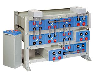

24 Volts DC, 1148 Ah at 20 Hr rate. The EnergyCell RE high capacity battery family offers an ideal solution for large capacity Valved Regulated Lead Acid (VRLA) battery requirements. The high capacity battery’s steel can (module) design concept, with its integral racking system, provides a cost effective battery system with a compact, quick and simple installation process. Its AGM technology incorporates an enhanced cell design with a superior racking system. The enhanced cell incorporates thicker positive plates for longer life. The welded/epoxy dual post seal design provides the highest integrity seal in the industry. The large copper post design also enhances the high rate performance.
The EnergyCell RE high capacity battery provides excellent performance and service life in grid-tied, grid-interactive and off-grid renewable energy and UPS solutions.
- Nominal Voltage Per Cell: 2 VDC
- Total Voltage: 24 VDC
- Optimal Temperature Range: 73.4°F - 78.8°F
- Float Voltage Per Cell: 2.25 VDC (77°F)
- Equalization Voltage Per Cell: 2.32 VDC (69.8°F - 89.6°F)
- Maximum Charging Current: 250 Amps
- Internal Resistance: 270 microOhms (0.000270 Ohms)
- Terminal Hardware: M8 bolt, lock washer and flat washer
- Total Weight: 2,202 lbs.
- Dimensions H x W x D inches: 34.81 x 37.15 x 26.25
- Amp-hour Capacity @20 Hr rate: 1,148 Ah
Warranty: 3 years
