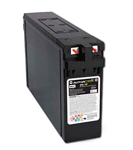

OutBack Power's EnergyCell batteries are designed for residential, light-commercial grid-tied backup or off-grid renewable energy power demands. with 1,500 cycles at 50% DOD, pure lead extends the life of the battery versus traditional VRLA and allos for increased float capability and maximizes runtime for backup applications.
Batteries designed for residential, light-commercial grid-tied backup or off-grid renewable energy power demands.
Easy to install and maintain.
Optimized to work seamlessly with OutBack Power conversion equipment.
  • Cells Per Unit: 6
  • Voltage Per Unit: 12 VDC
  • Optimal Temperature Range: 68 to 77°F (20 to 25°C)
  • Float Charging Voltage: 13.5VDC
  • Equalization and Cycle Service Charging Limits: 14.4V
  • Terminal Type: M6
  • Weight: 132.3 lbs (59.9kg)
  • Dimensions H x D x W i(n/cm): 12.46" x 22.87" x 4.92" / 31.65 x 58.09 x 12.5
  • Amp-hour capacity @ 20 Hr Rate: 203.8 Ah
