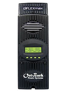

Outback Power FLEXmax FM80 MPPT Solar Charge Controller
FM80-150VDC

The Outback Power FLEXmax line of charge controllers stand out among their competition as one of the very best and most versatile controllers available. OutBack’s advanced MPPT algorithm delivers as much as 30% more power to your batteries vs standard PWM controllers and other types of chargers. The maximum power point tracking (MPPT) allows the unit to determine the best combination of voltage and current to maximize the amount of power it can send to your batteries. In addition to increased power and efficiency, this also allows you to design a more efficient solar array that takes advantage of a higher voltage than your battery system voltage. The FM80 can handle up to 150 Volts DC from the solar array, which is stepped down to the battery bank voltage.
The FM80 comes with a built-in 80 character display that shows you the current system status and data logs from the last 128 days. For more advanced functions and configuration, you can connect an optional MATE system display and controller. If you are using an Outback brand inverter, you can connect the FM80 and the inverter to a single MATE3 controller using a HUB communications manager. Only the MATE3 controller is compatible with new Outback inverters.
