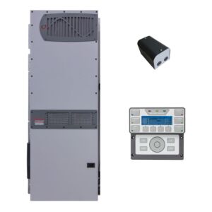

OutBack Power 4kW Radian AC Coupling Bundle
Give the peace of mind that comes with having backup power in the event of a utility outage. The Radian Series AC Coupling bundles from OutBack enable existing grid-tied systems to tap into the flexibility and freedom of battery backup in the face of the evolving energy landscape.
AC Coupling Bundle Contents:
- Radian Series GS4048A Inverter/Charger
- GSLC175-120/240 Load Center
- MATE3s (and mounting bracket)
- Generator Protection Kit
- 30A Dual Pole Breaker (for connecting the grid-tied inverter inside the GS load center)
