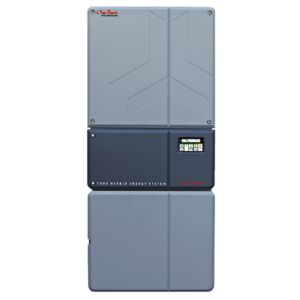

The OutBack Power SkyBox makes smart solar simple with an advanced technology single-box design, and represents a breakthrough in the field of advanced power conversion, processing and control. The fully integrated design of the SkyBox system eliminates external charge controllers and communication boxes, significantly cutting installation time and cost. Ease-of-installation makes this energy solution ideal for installers interested in following the market’s move towards battery-based systems.

SBX5048-120/240 Specifications:
  • AC Voltage: 120/240V split-phase
  • AC Frequency: 60 Hz
  • Max Continuous AC Output Power: 5,000 VA (Volt-Amps)
  • Max Continuous Output Current (@240V): 24 Amps @ 25 °C
  • Power Factor at Rated Power: 1
  • Max PV System Voltage: 600V
  • PV Input Voltage Range: 200V - 600V
  • MPPT Voltage Range: 250V - 600V
  • Max Input Current: 20 Amps
  • Max Short Circuit Current: 32 Amps
  • Typical Inverter Efficiency: 97%
  • Listings & Certifications: UL 1741 SA, CSA 22.2 No. 107.1, UL 1778, HECO Rule 14H SRD, CA Rule 21 SRD, IEEE 1547-2003, IEEE 1547.1-2005
  • Weight: 110.6 pounds
  • Dimensions (H x W x D): 47" x 21 x 9.4" inches
