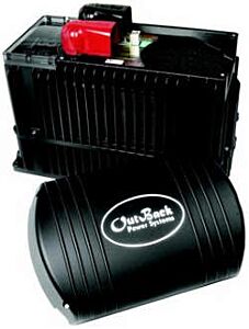

Outback VFX3648M 3600 Watts, 48 VDC Pure Sine Wave Inverter & Charger
Outback sealed VFX3648M mobile "M" series inverter with built-in AC transfer switch. The VFX vented M series inverters are perfectly suited for mobile, marine, and RV applications. Constructed of die-cast aluminum, the inverter can be mounted in any position and most locations. The built-in neutral ground switching makes connecting to a generator or shore power very easy. The inverter automatically engages and disengages the neutral ground bond depending on whether or not the AC system requires it. The built-in transfer switch operates so quickly that there's never a lapse in power to any of your devices. All Outback inverters are user serviceable in the field. The factory tests every inverter under very demanding conditions, but sometimes parts need to be replaced. Outback makes this fairly simple by offering replacement boards that are basically plug and play. You remove the faulty board and insert the new board in its place, and then you're back up and running again. This prevents you from having to send your inverter to the factory for repairs.
