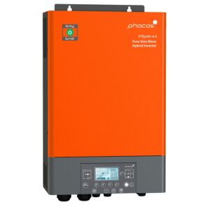

Phocos 3,000 Watt 24 Volt Hybrid Inverter
NOTE: The Phocos Any-grid can use grid power to charge batteries or pass through to loads in a net zero application but is not capable of selling power to the US grid.
The Phocos Any-Grid Inverter Charger Series (Pure Sine Wave Hybrid) represents Phocos’ most versatile line of inverters/chargers. Flexibility and reliability are key characteristics of this product line, with a strong potential for cost saving opportunities in real world conditions. The Any-Grid Hybrid Inverter converts DC (Direct Current) energy into AC (Alternating Current), with multiple advantages beyond standard inverters. This product includes an integrated MPPT charge controller and can function as an AC to DC battery charger, which provides flexible energy access solutions in a broad range of applications.
The battery can be charged from solar and/or an AC source (public grid or generator), with easily programmable priorities. It can function without an AC source or alternatively even without solar, as a pure uninterruptible power supply (UPS). When the utility grid or AC generator fails, the Any-Grid Hybrid Inverter immediately switches to ‘Off-Grid’ mode within 10 ms (typical, in UPS mode) to securely power the loads at all times. Solar can be set as the priority energy source to save electricity costs.
The Any-Grid Hybrid Inverter can function in a battery-free mode. In this mode, for installations with stable public grids, grid energy consumption can be reduced without the need to invest in a costly battery bank. Additionally, power can be supplied directly to loads from the grid and solar simultaneously.
This unit comes with a quality, integrated MPPT charge controller. The controller accepts particularly high PV voltages, allowing many PV modules to be connected in series, decreasing installation cost and avoiding combiner boxes. Up to 9 inverters can be connected in parallel or 3-phase for up to 45 kW of synchronized AC power.
