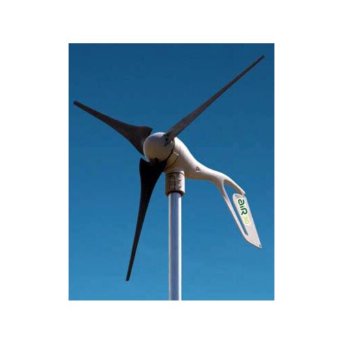

Ryse Energy AIR 30 24VDC Wind Turbine
The Ryse Energy(formally known as Primus Wind Power) AIR 30 model 1-AR30-10-24 wind generator is for land use only and designed to work best in high wind environments. The body is constructed of permanent mold cast aluminum and the three blades are made of carbon-molded composite. The generator can be used for multiple types of off grid power applications including telecommunications, security systems, cathodic protection, cabins and trailers. It can also be used in conjunction with a solar system to supplement battery charging. The AIR 30 will produce 30 kWh per month with an average wind speed of 13 miles per hour and requires a start up wind speed of 8 mph. It comes with a built-in microprocessor controlled charge controller and the option of using an external load diversion controller. The wind generator cannot be connected directly to a power inverter. It must be used to charge a 24 volt battery bank. Your inverter will get its power from the batteries.
Comes with a 5 year manufacturer's warranty.
Ryse Energy AIR 30 power graph
Energy Approx. 30 kWh/mo at 5.8 m/s (13 mph)
Swept Area 1.07 m2 (11.5 ft2)
Rotor Diameter 1.17 m (46 in)
Weight 5.9 kg (13 lb)
Startup Wind Speed 3.58 m/s (8 mph)
Voltage 24 Volts DC
Turbine Controller Mircoprocessor-based smart controller
Body Permanent mold cast aluminum
Blades (3) Injection-molded composite
Alternator Permanent magnet brushless
Overspeed Protection Electronic torque control
Survival Wind Speed 49.2 m/s (110 mph)
Mount 1.5 in schedule 40 pipe 48 mm (1.9 in) outer diameter
Wind Speed Operating Range 3.6-22 m/s (8-49 mph)
Optimum Wind Speed Range 11-15 m/s (25-32 mph)
