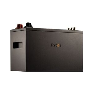

The Pytes E-Box 12100 embodies the pinnacle of energy storage solutions, tailored for a wide array of 12VDC applications. This lithium iron phosphate (LiFePO4) battery is engineered to cater to the demanding needs of solar energy systems, RV and Marine Systems, backup power applications, and off-grid energy solutions. With its impressive capability to deliver up to 1.280kWh of energy storage upon complete discharge and a maximum power rating of 100A, this battery stands as a testament to high-capacity, reliable power storage.
Key Features:
  • High-Capacity Storage: The E-Box 12100 can store up to 1.280kWh of energy, making it perfect for those who need reliable power for extended periods.
  • Parallel Connection: For applications requiring more power, up to eight E-Box 12100 batteries can be connected in parallel, offering up to 10kWh of storage. For needs surpassing this, we invite discussions with our engineers for tailored recommendations.
  • Closed Loop Communications: Integrating seamlessly with Victron Equipment, the E-Box 12100 utilizes advanced closed loop communication for superior management and monitoring of your battery system. This feature enhances the battery management system (BMS) efficiency, ensuring optimal performance and longevity of your battery. Learn more about the importance of closed loop communications and its impact on battery systems here.
  • Continuous Loading Capabilities: With a recommended continuous current output of 75A, the E-Box 12100 is designed to provide a steady flow of power up to 960 watts per battery without compromising the internal BMS limitations and overload protection. This ensures the battery's durability and reliability across all applications.
  • System Design Flexibility: A single E-Box 12100 battery can support approximately 960 watts of inverter output power. For more demanding systems, such as a 3000W 12V inverter, it is recommended to utilize 3-4 batteries to fulfill the potential power draw efficiently.
Our dedicated team of design engineers are available to address any questions relating to system designs and battery limitations. Whether you're exploring options or need detailed assistance in choosing the proper battery setup for your application, we're here to help guide you every step of the way. The NAZ Approach, a cornerstone of our engineering and design philosophy, emphasizes the importance of customization and optimization in system design to meet the specific needs of each application. This approach ensures that every solution we provide is not only efficient but also sustainable and reliable over its lifetime. For more insights into the NAZ Approach and how it influences our designs, visit this link.
  • Nominal Voltage: 12.8V
  • Nominal Capacity: 100Ah
  • Nominal Energy: 1.28kWh
  • Chemistry: Lithium Iron Phosphate(LiFePO4)
  • Maximum Continuous Charging Current: 50A (0.5C)
  • Maximum Continuous Discharging Current: 100A (1C)
  • Communication Protocol: RS485, CAN
  • Dimension(L*W*H): 12.6"x 6.5"x 7.9"
  • Weight: 33.6 lbs
