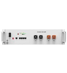

Pytes E-BOX series, a 5.12kWh Lithium Ferro Phosphate(LFP) battery for residential and commercial energy storage systems. It provides a safe, reliable, and high-performance solution for Lithium Battery applications. The Pytes battery pack offers compact design, that’s easy to install, and is completely maintenance free. These batteries can be deployed in a parallel configuration up to 286kWh. Commonly used for residential, commercial, and industrial applications with 48V Inverter Equipment; also can be used with 48V telecom or stand-alone applications without inverters.
The 48100R TE+ can be added to existing systems with Pytes 48100R batteries. The 48100R TE+ battery uses a different power connector compared to the 48100R battery. Each battery comes with a pair of battery to inverter cables used to connect to busbar. please contact us to purchase the battery-to-battery cable if you would like to parallel the 48100R TE+ to a 48100R battery using short jumpers.
Please note: The capacity can be increased by connecting the batteries in parallel, but due to the limitations of BMS and power cable, Max. 16 batteries can be connected in parallel as a group without any additional kits and a bus bar should be used for connecting them together. Only batteries marked with C16 label on the battery carton and SN code support a maximum of 16 units in parallel in one group. Otherwise, only a maximum of 8 units in parallel is supported. Installations with greater than or equal to 8 batteries will require the: Pytes Battery Hub
