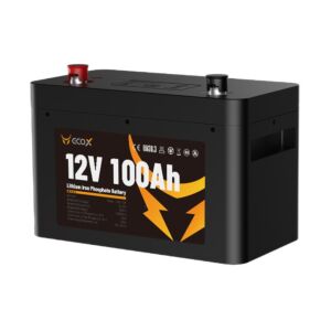

The Pytes Ecox 12100 is a lithium iron phosphate battery module. It is designed to replace deep-cycle lead-acid batteries. The battery is perfect for recreational vehicles (RV), caravans, marine (boats), trucks, cabins, and other off-grid deep-cycle applications
Key Features:
  • High Reliability: The built-in advanced BMS manages charging and discharging status, helps in balancing the individual cells, and ensures intelligent automatic protection against over-voltage, under-voltage, over-current, over-temperature, under-temperature and short circuit.
  • Low Self-discharge Loss: The battery can be stored for more than 12 months if it has been disconnected from other devices.
  • Energy Expansion: The battery supports up to 1 in series and 8 in parallel (Max. 1S8P) to build a 12 V 800 Ah battery system.
  • Heating Film: With the heating film, the battery can work in an extremely-cold environment.
Our dedicated team of design engineers are available to address any questions relating to system designs and battery limitations. Whether you're exploring options or need detailed assistance in choosing the proper battery setup for your application, we're here to help guide you every step of the way. The NAZ Approach, a cornerstone of our engineering and design philosophy, emphasizes the importance of customization and optimization in system design to meet the specific needs of each application. This approach ensures that every solution we provide is not only efficient but also sustainable and reliable over its lifetime. For more insights into the NAZ Approach and how it influences our designs, visit this link.
  • Nominal Voltage: 12.8V
  • Nominal Capacity: 100Ah
  • Nominal Energy: 1.28kWh
  • Chemistry: Lithium Iron Phosphate(LiFePO4)
  • Maximum Continuous Charging Current: 100A (0.5C)
  • Maximum Continuous Discharging Current: 100A (1C)
  • Communication Protocol: BLE 5.0
  • Dimension(L*W*H): 12.8"x 6.83"x 9.37"
  • Weight: 26.46 lbs
