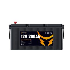

The Pytes Ecox 12200 is a smart lithium iron phosphate battery module. It is designed to replace deep cycle lead-acid batteries. With a standard BCI 4D size, it is perfect for recreational vehicles (RV), marine (boats), trucks, cabins, and other off-grid deep-cycle applications.
Key Features:
  • High Reliability: Adopting advanced BMS, the battery has comprehensive protection functions.
  • Low Self-discharge Loss: With Energy Storage Grade LiFePO4 Cells, the battery extends its cycle life to more than 8 times that of lead-acid batteries.
  • Energy Expansion: With the high energy density lithium cells, the battery is 50% the weight of the lead acid battery of equivalent energy, and 70% the size of the regular lithium battery of equivalent energy. It's easier to carry, faster to charge, and more convenient to use.
  • Strong Environmental Adaptability: With low-temperature smart heating function, the battery can be charged safely in sub-zero temperatures.
  • Real-time Monitoring via App: You can monitor the battery status via App.
  • Low Self-discharge Loss: The battery can be stored for over 2 months if it is turned off after being fully discharged, and can be stored for over 6 months if it is turned off when its level is between 40% and 70%.
Our dedicated team of design engineers are available to address any questions relating to system designs and battery limitations. Whether you're exploring options or need detailed assistance in choosing the proper battery setup for your application, we're here to help guide you every step of the way. The NAZ Approach, a cornerstone of our engineering and design philosophy, emphasizes the importance of customization and optimization in system design to meet the specific needs of each application. This approach ensures that every solution we provide is not only efficient but also sustainable and reliable over its lifetime. For more insights into the NAZ Approach and how it influences our designs, visit this link.
  • Nominal Voltage: 12.8V
  • Nominal Capacity: 200Ah
  • Nominal Energy: 2.56kWh
  • Chemistry: Lithium Iron Phosphate(LiFePO4)
  • Maximum Continuous Charging Current: 100A (0.5C)
  • Maximum Continuous Discharging Current: 100A (1C)
  • Communication Protocol: BLE 5.0
  • Dimension(L*W*H): 19.5"x 7.5"x 8.5"
  • Weight: 45.98 lbs
