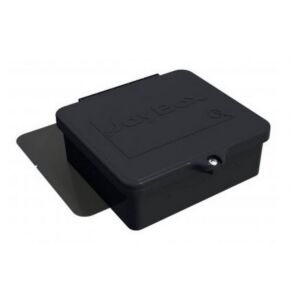

JayBox™ is an ever-adaptable junction box, designed to securely enclose wires on nearly any solar project—with ample space to shelter up to 4 module strings.
The box is UL-listed, NEMA-3R-rated, and supports up to 1500-volt systems. It is made of a NORYL™ resin, known for its long-lasting UV-resistance and impact strength.
JayBox™ is available in two options: Roof Mount and Rail Mount—so you can keep all of your solar wires nested and protected.
  • Two Mounting Types JayBox™ Roof Mount comes with deck screws and a flashing, while JayBox™ Rail Mount comes with rail hangers.
  • Trusted Waterproofing JayBox™ Roof Mount utilizes QuickMount’s Elevated Water Seal Technology® that has passed the TAS-100 wind-driven rain test.
  • Hassle-Free Lid A detachable, hinged lid reduces interference—staying open and out of the way even on up to 70° roof slopes.
  • Captive Hardware Once the lid is closed, the single, pre-installed, captive screw and nut keeps it snug and secure.
  • Drilling Guides The enclosure has easy-to-drill guides on three sides of the box as well as inside for directing conduit from the attic.
  • Durable NORYL™ Resin JayBox™ is fabricated from SABIC’s NORYL™ resin, giving it greater strength and resistance to UV radiation. It is well known for its lasting stability and performance in extreme environments.
  • *6 screws are also provided for attaching DIN rail and a grounding bar inside.
