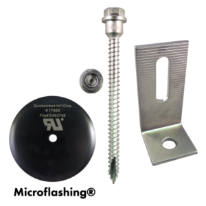

QuickBOLT 17662 Multi Roof Mount
Multi Roof Mount - 5/16 X 4" QuickBOLT2 Kit with 3" Microflashing and SS Low Profile L-Foot 25/Kit - Weight/Kit = 11.00 Lbs Asphalt Shingle roofs, TPO roofs, EPDM roofs
The QB2 Kit is the Fastest and easiest way to mount Solar to a variety roofs Sealant is Optional. Leak Proof-Water Test Results - Sealant is Optional.
  • ASTM E331 @ 15.00psf No Leakage.
  • ASTM E331 (modified), 120 min @ 30.00 PSF No Leakage.
  • ASTM E2124 (modified), 6" water column for 7 days No Leakage.
Dual Drive System use either Standard 1/2" Hex or 6MM Hex Insert Bit.
To compress MicroFlashing® properly with QB2 requires 150 Minimum Torque Lbs/Inch.
The 10MM x 46MM rail slot accepts 5/16" or 3/8" bolts. Compatible with Rail and Most Railless Systems Including Snap N Rack, Unirac, IronRidge and Eco Fasten. Simply Drill, seal, and mount!
