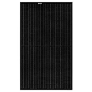

N-PEAK Black 320 Specifications:
  • Nominal power: 320 Watts
  • Number of cells: 120
  • Power tolerance: 0 / +5 Watts
  • Vmp: 34.2 Volts
  • Voc: 40.3 Volts
  • Imp: 9.37 Amps
  • Isc: 10.22 Amps
  • Module efficiency: 19.2%
  • Dimensions (inches): 65.9" x 39.25" x 1.1"
  • Dimensions (mm): 1675 x 997 x 30
  • Weight: 39.7 lbs (18 kg)
