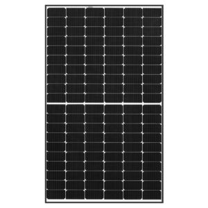

REC Solar 360 Watt Alpha Series Monocrystalline Module
This is the REC Alpha; one of the world’s most powerful 120-cell solar panels, empowering you to take full advantage of solar energy. With 360 Wp power and impressive 19.15 W/ft², REC Alpha delivers over 20% more power, making it the panel of choice for rooftop owners who seek the best.
Heterojunction (HJT) Cell Technology
  • No LID = no power loss; you get the power you pay for
  • Leading temperature coefficient means more energy as temperature rises
  • Maximum power for maximum savings and accelerated return on investment
  • Its leading power density (217 watts/m²) is ideal to get the most from limited spaces
  • Over 20% more power on your roof compared to conventional panels
Advanced Cell Connection Technology
  • Increased number of wires greatly improves flow of electricity current
  • Eliminating invasive soldering removes risk of cell damage or microcracks for long-lasting high performance
  • Stylish looks thanks to thin, barely-visible wires and uniformly black-colored cells
  • Full-black variant is a design masterpiece and the most elegant feature for your home
  • Solder-free cells reduces lead content by a colossal 81%
  • Environmentally-friendly manufacturing drastically reduces carbon footprint
REC’s Iconic Twin Panel Design
  • Award-winning design, pioneered by REC
  • Panel split into two ‘Twin’ sections
  • Reduces internal resistance for more power and reliability
  • Continued energy production in shaded conditions means you see higher energy yields
Super-strong Frame
  • Support bars protect cells and glass from bending under load
  • Allows extreme loads up to 7000 Pa
  • Panels maintain high performance levels over the installation lifetime
  • 30 mm (1.8") frame height makes panel easier to handle
Industry-leading Warranty
  • 25 year product warranty*: covers any panel defects
  • 25 year performance warranty: ensures panels perform exactly as they’re expected to – every year for 25 years
  • 25 year labor warranty*: gives added protection in case a panel needs to be serviced
  • At least 92% of nameplate power in year 25; an industry best
  • Unprecedented savings, more economic security, and greater energy autonomy for consumers
  • * when installed by a REC Certified Solar Professional installer; part of the REC ProTrust Warranty
REC360AA Specifications
Nominal Power: 360 Watts
Watt Class Sorting: -0/+5
Vmp: 36.7 Volts
Imp: 9.82 Amps
Voc: 43.9 Volts
Isc: 10.49 Amps
Panel Efficiency: 20.6%
Dimensions: 67.8" x 40" x 1.2" (30mm)
Weight: 43 lbs.
SKU: REC360AA
