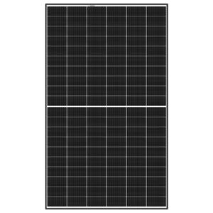

REC Solar 365 Watt Alpha Series Monocrystalline Module
This is the REC Alpha; the world’s most powerful 60-cell solar panel, empowering you to take full advantage of solar energy. With 365 Wp power and impressive 19.4 W/ft², REC Alpha delivers over 20% more power, making it the panel of choice for rooftop owners who seek the best.

REC365AA Specifications
Nominal Power: 365 Watts
Watt Class Sorting: -0/+5
Vmp: 37.1 Volts
Imp: 9.85 Amps
Voc: 44.0 Volts
Isc: 10.52 Amps
Panel Efficiency: 20.9%
Dimensions: 67.8" x 40" x 1.2" (30mm)
Weight: 43 lbs.
SKU: REC365AA
