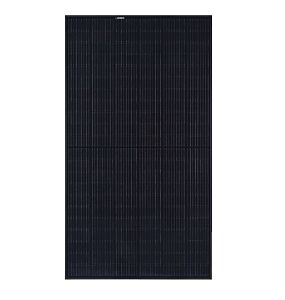

The REC N-Peak 3 Black is the the third generation of REC's n-type TOPCon cell-based solar panels. With its improved power density, the REC N-Peak 3 Black will give consumers higher savings on electricity bills and carbon emissions. , one challenge might be how to make efficient use of the space available for the installation. With the REC N-Peak 3 Series, that’s how. These panels enable you to pack in higher power into a limited space and achieve greater power levels with fewer panels.
Features
The REC N-Peak 3 Series are premium n-type mono solar panels using REC’s proven half-cut cell technology. What does this mean? High efficiency, high power, and high quality.
PURE POWER FROM REC
With up to 380 Wp in a 132-cell format panel, the REC N-Peak 3 Series uses the most efficient cell technology in the industry, capturing more sunlight thereby providing more power. The panel features the innovative REC ‘Twin’ cell layout design, where the panel is split into two twin sections, also enabling continued energy production, even when partially shaded.
ZERO LID:
The loss of power generation capacity experienced by a standard solar panel on its first exposure to light is known as Light Induced Degradation (LID). This is a result of the combination of boron and oxygen inside a cell and causes a permanent drop in a standard panel’s maximum power. Not with the REC N-Peak 3 Series, however!
The n-type technology in REC’s N-Peak cells stops these two elements from mixing at any level, thereby fully preventing any occurrence of LID. Thus, the panel’s power remains the same as when it left the REC factory – meaning you always get exactly the power levels that you paid for.
SUPER-STRONG FRAME DESIGN:
The REC N-Peak 3 Series has extra support bars across the rear of the panel, greatly boosting its strength and durability, and allowing loads of up to 7000 Pa – far exceeding the 5400 offered by conventional panels. This added strength enables you to achieve much higher energy yields. Combined with a 30 mm frame height, this frame design enables flexible installation options, making overcoming every obstacle easier during system design.
Variants
REC N-Peak 3 panels come standard with black-colored half-cut mono-crystalline cells, a black frame, and a black back sheet making it uniformly full black.
REC400NP3 Black Specifications:
  • Nominal power: 380 Watts
  • Number of cells: 132 half-cut
  • Power tolerance: 0 / +5 Watts
  • Vmp: 36.0 Volts
  • Voc: 44.5 Volts
  • Imp: 10.54 Amps
  • Isc: 11.22 Amps
  • Module efficiency: 19.0%
  • Dimensions (inches): 74.8" x 40.9" x 1.2"(30mm)
  • Weight: 48.0 lbs
