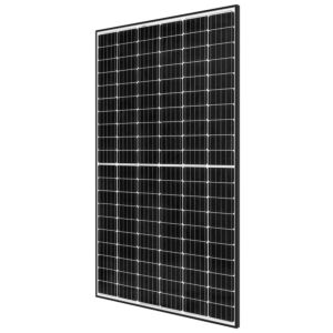

REC N-PEAK 315 Watt Monocrystalline Solar Panel
The REC N-Peak Series are premium n-type mono solar panels using REC’s proven half-cut cell technology. The panel features the innovative REC ‘Twin’ cell layout design, where the panel is split into two twin sections, also enabling continued energy production, even when partially shaded. The REC N-Peak Series has extra support bars across the rear of the panel, greatly boosting its strength and durability, and allowing loads of up to 7000 Pa.
N-PEAK 315 Specifications:
- Nominal power: 315 Watts
- Number of cells: 120 half-cut
- Power tolerance: +5 / -0 Watts
- Vmp: 33.9 Volts
- Voc: 40.5 Volts
- Imp: 9.31 Amps
- Isc: 10.09 Amps
- Module efficiency: 18.9%
- Dimensions (inches): 65.9" x 39.25" x 1.1"
- Dimensions (mm): 1675 x 997 x 30
- Weight: 39.7 lbs (18 kg)
Warranty: 20 year product warranty, 25 year linear power output warranty.
