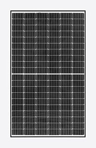

REC N-PEAK 325 Watt Monocrystalline Solar Panel
The REC N-Peak Series are premium n-type mono solar panels using REC’s proven half-cut cell technology. The panel features the innovative REC ‘Twin’ cell layout design, where the panel is split into two twin sections, also enabling continued energy production, even when partially shaded. The REC N-Peak Series has extra support bars across the rear of the panel, greatly boosting its strength and durability, and allowing loads of up to 7000 Pa.
N-PEAK 325 Specifications:
  • Nominal power: 325 Watts
  • Number of cells: 120 half-cut
  • Vmp: 34.4 Volts
  • Voc: 40.7 Volts
  • Imp: 9.46 Amps
  • Isc: 10.28 Amps
  • Module efficiency: 19.5%
  • Dimensions (inches): 65.9" x 39.25" x 1.1"
  • Dimensions (mm): 1675 x 997 x 30
  • Weight: 39.7 lbs (18 kg)
