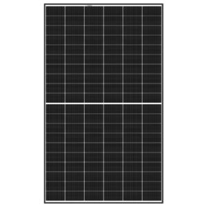

REC Alpha Series modules are made with heterojunction cell technology that reduces temperature coefficients and eliminates LID. Alpha modules combine the best attributes of thin film and crystalline PV technology to offer high power density and excellent quality.
Heterojunction (HJT) Cell Technology
  • No LID = no power loss; you get the power you pay for
  • Leading temperature coefficient means more energy as temperature rises
  • Maximum power for maximum savings and accelerated return on investment
  • Its leading power density (217 watts/m²) is ideal to get the most from limited spaces
  • Over 20% more power on your roof compared to conventional panels
Advanced Cell Connection Technology
  • Increased number of wires greatly improves flow of electricity current
  • Eliminating invasive soldering removes risk of cell damage or microcracks for long-lasting high performance
  • Stylish looks thanks to thin, barely-visible wires and uniformly black-colored cells
  • Full-black variant is a design masterpiece and the most elegant feature for your home
  • Solder-free cells reduces lead content by a colossal 81%
  • Environmentally-friendly manufacturing drastically reduces carbon footprint
REC’s Iconic Twin Panel Design
  • Award-winning design, pioneered by REC
  • Panel split into two ‘Twin’ sections
  • Reduces internal resistance for more power and reliability
  • Continued energy production in shaded conditions means you see higher energy yields
Super-strong Frame
  • Support bars protect cells and glass from bending under load
  • Allows extreme loads up to 7000 Pa
  • Panels maintain high performance levels over the installation lifetime
  • 30 mm (1.8") frame height makes panel easier to handle
Industry-leading Warranty
  • 25 year product warranty*: covers any panel defects
  • 25 year performance warranty: ensures panels perform exactly as they’re expected to – every year for 25 years
  • 25 year labor warranty*: gives added protection in case a panel needs to be serviced
  • At least 92% of nameplate power in year 25; an industry best
  • Unprecedented savings, more economic security, and greater energy autonomy for consumers
  • * when installed by a REC Certified Solar Professional installer; part of the REC ProTrust Warranty
REC375AA Specifications
  • Nominal Power: 375 Watts
  • Watt Class Sorting: -0/+5
  • Vmp: 37.1 Volts
  • Imp: 9.85 Amps
  • Voc: 44.0 Volts
  • Isc: 10.52 Amps
  • Panel Efficiency: 21.4%
  • Dimensions: 67.8" x 40" x 1.2" (30mm)
  • Weight: 43 lbs
