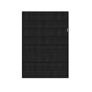

Building on REC's multiple award-winning innovations, the REC Alpha Pure family of solar panels empowers you to take full advantage of solar energy. Packing in cutting-edge technologies to deliver higher power density, stunning aesthetics, and minimal environmental impact – all with the renowned quality of REC – REC Alpha Pure and Pure-R are the solar panels of choice for home solar.
Heterojunction (HJT) Cell Technology
  • No LID = no power loss; you get the power you pay for
  • Leading temperature coefficient means more energy as temperature rises
  • Higher power for greater savings and accelerated return on investment
  • With high power density (watts/m²), REC Alpha panels generate more energy from the same area, getting more from limited spaces
  • REC Alpha Series delivers around 16% more power on your roof compared to conventional panels
Advanced Cell Connection Technology
  • Increased number of wires greatly improves flow of electricity current
  • Eliminating invasive soldering removes risk of cell damage or microcracks for long-lasting high performance
  • Stylish looks thanks to thin, barely-visible wires and uniformly black-colored cells
  • Full-black variant is a design masterpiece and the most elegant feature for your home
  • Solder-free cell
  • Environmentally-friendly manufacturing drastically reduces carbon footprint
Gapless cell layout
  • Innovative gapless cell layout increases active area of the panel to capture more sunlight
  • Boosts power density to impressive 223 watts/m², with panel power reaching 430 Wp
  • Higher power in a compact panel size
  • Elegant full-black design
Pioneering panel designs
  • REC's award-winning and iconic Twin design splits the REC Alpha Pure into two ‘Twin’ sections
  • Reduces internal resistance for more power and reliability
  • Continued energy production in shaded conditions means you see higher energy yields
  • REC Alpha Pure-R takes this further and divides the panel into four sections, producing even more energy in shade
Super-strong Frame
  • Support bars protect cells and glass from bending under load
  • Allows extreme loads up to 7000 Pa
  • Panels maintain high performance levels over the installation lifetime
  • 30 mm (1.8") frame height makes panel easier to handle
  • Frame design allows optimized transportation: more panels/pallet = more panels/container = fewer trucks on the road = more savings
Lead free
  • Lead-Free*
  • Lead removed from all panel components, including cell connections, cross connectors and junction box soldering
  • No toxic leakage of lead after recycling
  • Enables homeowners to boost environmental impact and lower overall carbon footprint even more
Industry-leading Warranty
  • 25 year product warranty*: covers any panel defects
  • 25 year performance warranty: ensures panels perform exactly as they’re expected to – every year for 25 years
  • 25 year labor warranty*: gives added protection in case a panel needs to be serviced
  • At least 92% of nameplate power in year 25; an industry best
  • Unprecedented savings, more economic security, and greater energy autonomy for consumers
  • * when installed by a REC Certified Solar Professional installer; part of the REC ProTrust Warranty
REC450AA-PURE-RX Specifications
  • Nominal Power: 450 Watts
  • Watt Class Sorting: -0/+5
  • Vmp: 54.3 Volts
  • Imp: 8.29 Amps
  • Voc: 65.1 Volts
  • Isc: 8.81 Amps
  • Panel Efficiency: 21.6%
  • Dimensions: 68" x 47.4" x 1.2" (30mm)
  • Weight: 50 lbs
