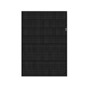

REC Solar REC470AA-PURE-RX Alpha Series 470 Watt Module
REC470AA Pure-RX
$349.14
Note: This product is discontinued. Please see our REC460AA Pure-RX instead.

REC470AA-PURE-RX Specifications
  • Nominal Power: 470 Watts
  • Watt Class Sorting: -0/+5
  • Vmp: 55.4 Volts
  • Imp: 8.49 Amps
  • Voc: 65.6 Volts
  • Isc: 8.95 Amps
  • Panel Efficiency: 22.6%
  • Dimensions: 68" x 47.4" x 1.2" (30mm)
  • Weight: 50 lbs
    SKUREC470AA Pure-RX
