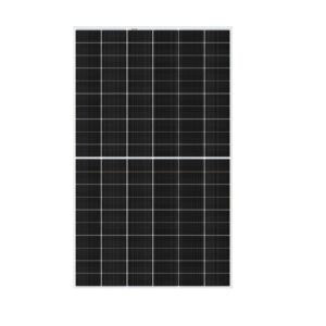

REC Solar REC610AA Pro M Alpha Pro M Series 610 Watt Commercial PV Module
REC610AA Pro M
$317.20
Note: This panel is only available in container quantities for commercial Systems, Please give us a call if you wish to order this module.
REC Solar Alpha Series 610 Watt Module
Heterojunction (HJT) Cell Technology
  • No LID = no power loss; you get the power you pay for
  • Leading temperature coefficient means more energy as temperature rises
  • Higher power for greater savings and accelerated return on investment
  • With high power density (watts/m²), REC Alpha panels generate more energy from the same area, getting more from limited spaces
  • REC Alpha Series delivers around 16% more power on your roof compared to conventional panels
Advanced Cell Connection Technology
  • Increased number of wires greatly improves flow of electricity current
  • Eliminating invasive soldering removes risk of cell damage or microcracks for long-lasting high performance
  • Stylish looks thanks to thin, barely-visible wires and uniformly black-colored cells
  • Full-black variant is a design masterpiece and the most elegant feature for your home
  • Solder-free cell
  • Environmentally-friendly manufacturing drastically reduces carbon footprint
Gapless cell layout
  • Innovative gapless cell layout increases active area of the panel to capture more sunlight
  • Higher power in a compact panel size
  • Elegant full-black design
Super-strong Frame
  • Support bars protect cells and glass from bending under load
  • Allows extreme loads up to 7000 Pa
  • Panels maintain high performance levels over the installation lifetime
  • 30 mm (1.8") frame height makes panel easier to handle
  • Frame design allows optimized transportation: more panels/pallet = more panels/container = fewer trucks on the road = more savings
Industry-leading Warranty
  • 25 year product warranty*: covers any panel defects
  • 25 year performance warranty: ensures panels perform exactly as they’re expected to – every year for 25 years
  • 25 year labor warranty*: gives added protection in case a panel needs to be serviced
  • At least 92% of nameplate power in year 25; an industry best
  • Unprecedented savings, more economic security, and greater energy autonomy for consumers
  • * when installed by a REC Certified Solar Professional installer; part of the REC ProTrust Warranty
REC Specifications
  • Nominal Power: 610 Watts
  • Watt Class Sorting: -0/+5
  • Vmp: 36.3 Volts
  • Imp: 16.81 Amps
  • Voc: 44.4 Volts
  • Isc: 17.56 Amps
  • Panel Efficiency: 21.5%
  • Dimensions: 85.6" x 51.4" x 1.2" (30mm)
  • Weight: 71.6 lbs
SKUREC610AA Pro M
