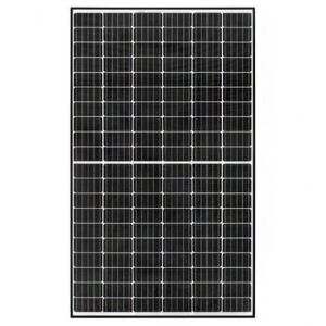

REC TwinPeak2 310 Watt Monocrystalline Solar Panel
Based on the multiple award-winning REC TwinPeak technology, REC TwinPeak 2 Mono panels bring heightened efficiency to REC's portfolio. Building on REC's long experience with half-cut cell technology, the TwinPeak 2 Mono Series uses p-type monocrystalline PERC cells, offering greater efficiency and power. This p-type mono variant offers higher power output per square meter of panels installed. Compared to standard 60-cell panels on a multicrystalline (poly) platform, you get at least 25 Wp more per panel!
The TwinPeak 2 Mono features an innovative design with the high panel efficiency and power output of monocrystalline cells, enabling you to get the most out of the space available. Panels with REC TwinPeak technologies have a unique “twin” design, which enables them to generate electricity even when they are partially shaded. Over time, you will get a higher yield from your array.
TwinPeak2 Mono 310 Specifications:
  • Nominal power: 310 Watts
  • Watt class sorting: 0 / +5
  • Number of cells: 120
  • Vmp: 33.5 Volts
  • Voc: 39.8 Volts
  • Imp: 9.26 Amps
  • Isc: 9.90 Amps
  • Module efficiency: 18.6%
  • Dimensions (inches): 65.9" x 39.25" x 1.5"
  • Dimensions (mm): 1675 x 997 x 38
  • Weight: 40.8 lbs (18.5 kg)
Warranty: 20 year product warranty, 25 year linear power output warranty.
