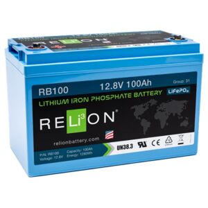

RELiON RB100 100 Amp-hour Lithium Ion 12 Volt Battery
Whether you’re powering your home or business, or mission-critical remote monitoring equipment, you want reliable power for your residential and commercial energy needs, both on and off the grid. RELiON Lithium Iron Phosphate (LiFePO4) batteries offer safe, clean and high power energy solutions for all types of renewable energy systems.
100 Cycles                99.7
500 Cycles                96.3
1000 Cycles              90.8
1500 Cycles              85.4
2000 Cycles              80.1
  • Amp Hours: 100 Ah
  • Capacity @ 25 A: 240 minutes
  • Energy: 1280 Wh
  • Voltage: 12.8 V Nominal
  • Peak Amps: 200 amps (7.5s ± 2.5s)
  • Group Size: 31
  • Dimensions (L x W x H): 12.95" x 6.77" x 8.8"
  • Weight (Battery Only): 30 lbs. / 13.5 kg
  • Efficiency: 99%
  • Recommended Charge Current: 50 A
  • Max Continuous Charge: 100 A
  • Max Continuous Discharge: 100 A
  • Discharge Voltage Cutoff: 8 V
  • Reconnect Voltage: 9.2 V
  • Charge Voltage Cutoff: 15.6 V
  • Reconnect Voltage: 15.2 V
