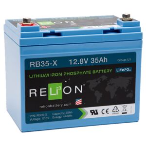

RELiON RB35-X 35 Amp-hour Lithium Ion 12 Volt Battery
Whether you’re powering your home or business, or mission-critical remote monitoring equipment, you want reliable power for your residential and commercial energy needs, both on and off the grid. RELiON Lithium Iron Phosphate (LiFePO4) batteries offer safe, clean and high power energy solutions for all types of renewable energy systems.
100 Cycles 99.7
500 Cycles 96.3
1000 Cycles 90.8
1500 Cycles 85.4
2000 Cycles 80.1
Relion RB35-X Specifications:
  • Amp Hours: 35 Ah
  • Capacity @ 25 A: 84 minutes
  • Energy: 448 Wh
  • Voltage: 12.8 V Nominal
  • Group Size: U1
  • Dimensions (L x W x H): 7.7" x 5.2" x 6.7"
  • Weight (Battery Only): 11.4 lbs. / 5.17 kg
  • Efficiency: 99%
  • Recommended Charge Current: 17.5 A
  • Max Charge Current: 70 A
  • Peak Discharge Current: 100 Amps (7.5 s ± 2.5 s)
  • Max Continuous Discharge: 70 A
  • Discharge Voltage Cutoff: 8 V
  • Reconnect Voltage: 8.64 V
  • Charge Voltage Cutoff: 15.6 V
  • Reconnect Voltage: 15.2 V
