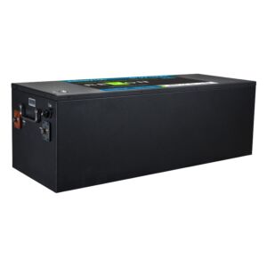

This 48V 100Ah lithium iron phosphate battery is perfect in many applications, including marine and electric vehicles. It maintains consistent power and is equipped with an LINYI Connector terminal type and a built-in battery management system (BMS). The RB48V100 battery meets UL, CE and IEC certifications.
All RELiON LiFePO4 batteries have installation flexibility, fast-charging capabilities and are maintenance free.
Relion RB48V100 Specifications:
- Amp Hours: 100 Ah
- Capacity @ 25 A: 240 minutes
- Energy: 5120 Wh
- Voltage: 51.2 V Nominal
- Dimensions (L x W x H): 32.8" x 11.2" x 10.0"
- Weight (Battery Only): 139 lbs. / 63 kg
- Efficiency: 99%
- Recommended Charge Current: 50 A
- Max Charge Current: 100 A
- Peak Discharge Current: 250 Amps (4 s ±1 s)
- Max Continuous Discharge: 200 A
- Operating Temperature: -4 to 131 F /-20 to 55 C
- Discharge Voltage Cutoff: 40 V
- Reconnect Voltage: 40.5 V
- Charge Voltage Cutoff: 60.8 V
- Reconnect Voltage: 60.3 V
- Cell Type: Cylindrical LiFeP04
