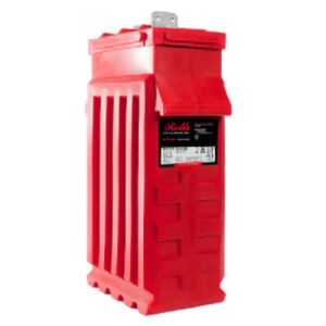

Rolls Surrette 2-OS-33PS - 2 Volts, 1955 Amp-hours
Roll's unique battery design features dual container construction. Each cell is self contained in a high temperatureretardant, durable polypropylene case. The outer container is made of high-density unbreakable polyethylene, providing double protection from breakage and acid leakage. Cell replacement is clear and concise with bolt-on connectors, allowing the battery to be assembled or repaired on location.
All Rolls 5000 Series Renewable Energy models now feature enhanced negative plate construction with Rolls Battery proprietary Advanced NAM carbon blend.
Voltage 2 Volts
Series 5000
Ampere Hours @ 20 Hour Rate 1955 Ah
Weight 221.5 lb / 100.5 kg
Length Width Height
in cm in cm in cm
15.44 39.2 8.31 21.1 24.81 63.0
