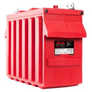

Rolls Surrette 6-CS-27P Deep Cycle Battery - 6 Volts, 929 Amp-hours
6-CS-27PS
$1,547.95
NOTE: Rolls Battery is behind in manufacturing. The 5000 series batteries currently have an 7-8 week lead time. Please email us or give us a call if you have any questions.
Note: This battery comes with 19" 4/0 interconnect cables.
Rolls Surrette 6-CS-27P - 6 Volts, 929 Amp-hours
Roll's unique battery design features dual container construction. Each cell is self contained in a high temperatureretardant, durable polypropylene case. The outer container is made of high-density unbreakable polyethylene, providing double protection from breakage and acid leakage. Cell replacement is clear and concise with bolt-on connectors, allowing the battery to be assembled or repaired on location.
All Rolls 5000 Series Renewable Energy models now feature enhanced negative plate construction with Rolls Battery proprietary Advanced NAM carbon blend.
Voltage 6 Volts
Series 5000
Ampere Hours @ 20 Hour Rate 929 Ah
Weight 341.5 lb / 155 kg
Length Width Height
in cm in cm in cm
22.0 55.9 11.25 28.6 18.25 46.4
Warranty: 5 years full replacement
