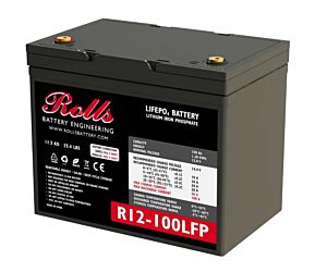

The Rolls Surrette R12-100LFP battery is a lithium iron phosphate (LiFePO4/LFP) battery that offers many advantages over traditional lead-acid batteries. It has a high energy density, a long cycle life, a low self-discharge rate, and a wide operating temperature range. It also has a built-in battery management system (BMS) that protects the battery from overcharging, overdischarging, short-circuiting, and overheating.
The Rolls Surrette R12-100LFP battery comes with a 3-year free replacement warranty when installed in renewable energy, marine or RV applications. It also comes with M8 stainless bolts & washers & TP08 adapter for easy installation and connection.
R12-100LFP Specifications:
  • Nominal Voltage: 12.8 Volts
  • Chemistry: LiFePO4
  • Nominal Energy: 1.28 kWh
  • Rated Capacity: 100 Amp-hours
  • Recommended Charge Voltage: 14.4 Volts
  • Maximum Continuous Charge Current: 50 Amps DC
  • Maximum Continuous Discharge Current: 100 Amps DC
  • Charge Temperature Range: 0°C to 55°C (32°F to 131°F)
  • Discharge Temperature Range: -20°C to 60°C (-4°F to 140°F)
  • Storage Temperature Range: -5°C to 45°C (23°F to 113°F)
  • Length: 10.24 inches
  • Width: 6.69 inches
  • Total Height: 8.3 inches
  • Weight: 25.4 lbs. (11.5 kg)
