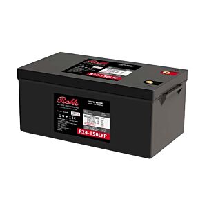

Rolls R24-150LFP
The Rolls Surrette R24-150LFP battery is a lithium iron phosphate (LiFePO4/LFP) battery that offers many advantages over traditional lead-acid batteries. It has a high energy density, a long cycle life, a low self-discharge rate, and a wide operating temperature range. It also has a built-in battery management system (BMS) that protects the battery from overcharging, overdischarging, short-circuiting, and overheating.
The Rolls Surrette R24-150LFP battery comes with a 3-year free replacement warranty when installed in renewable energy, marine or RV applications. It also comes with M8 stainless bolts & washers & TP08 adapter for easy installation and connection.
R24-150LFP Specifications:
  • Nominal Voltage: 25.6 Volts
  • Chemistry: LiFePO4
  • Nominal Energy: 3.84 kWh
  • Rated Capacity: 150 Amp-hours
  • Recommended Charge Voltage: 28.8 Volts
  • Maximum Continuous Charge Current: 75 Amps DC
  • Maximum Continuous Discharge Current: 150 Amps DC
  • Charge Temperature Range: 0°C to 55°C (32°F to 131°F)
  • Discharge Temperature Range: -20°C to 60°C (-4°F to 140°F)
  • Storage Temperature Range: -5°C to 45°C (23°F to 113°F)
  • Length: 20.5 inches
  • Width: 10.51 inches
  • Total Height: 8.78 inches
  • Weight: 73.6 lbs. (33.4 kg)
