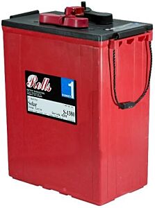

Rolls Surrette S-1660 - 2 Volts, 1284 Amp-hours
Voltage | 2 Volts | ||||
Series | 4000 | ||||
Ampere Hours @ 20 Hour Rate | 1284 Ah | ||||
Weight | 127 lb / 58 kg | ||||
Length | Width | Height | |||
in | mm | in | mm | in | mm |
12.5 | 318 | 7.125 | 181 | 17.00 | 432 |
Number of Cycles | ||
% Discharge | Series 4000 | Series 5000 |
20% | 2000 | 5000 |
30% | 1707 | 4200 |
40% | 1493 | 3700 |
50% | 1280 | 3200 |
60% | 1120 | 2800 |
70% | 960 | 2400 |
80% | 800 | 2100 |
90% | 700 | 1800 |
100% | 590 | 1500 |
