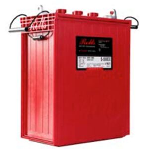

SURRETTE S-500EX SPECIFICATIONS
Voltage 6 Volts DC
Model Number S-500EX
Surrette Series 4500
Amp-hours @ 20 hour rate 357 Amp-hours
Chemistry Flooded Lead Acid
Weight 131.5 lb (60 kg)
Length 12.5 in (318 mm)
Width 7.125 in (181 mm)
Height 16.75 in (425 mm)
CYCLE LIFE VS. DEPTH OF DISCHARGE (DoD)
40% DoD Approximately 3100 Cycles
50% DoD Approximately 2750 Cycles
Warranty: 4 years full replacement
SKU: S-500EX
