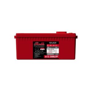

The Rolls Surrette S12-300LFP battery is a lithium iron phosphate (LiFePO4/LFP) battery that offers many advantages over traditional lead-acid batteries. It has a high energy density, a long cycle life, a low self-discharge rate, and a wide operating temperature range. It also has a built-in battery management system (BMS) that protects the battery from overcharging, overdischarging, short-circuiting, and overheating.
The Rolls Surrette S12-300LFP battery comes with a 3-year free replacement warranty when installed in renewable energy, marine or RV applications. It also comes with M8 stainless bolts & washers & TP08 adapter for easy installation and connection.
