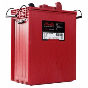

Rolls Surrette S2 L16-EX Flooded Deep Cycle Battery 2 Volts 1040 Amp-hours with Advanced NAM

Rolls Surrette S2 L16-EX 2 Volts 1040 Amp-hours Deep Cycle Battery

SURRETTE S2 L16-EX SPECIFICATIONS
Voltage 2 Volts DC
Model Number S2 L16-EX
Surrette Series 4500
BCI Group Size L16
Amp-hours @ 20 hour rate 1,040 Amp-hours
Chemistry Flooded Lead Acid
Weight 128 lb (58 kg)
Length 12.5 in (31.8 cm)
Width 7.13 in (18.1 cm)
Height (including terminals) 17.0 in (43.2 cm)
