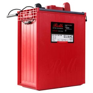

Rolls Surrette S2 L16-HC 2 Volts 1335 Amp-hours Deep Cycle Battery

| SURRETTE S2 L16-HC SPECIFICATIONS | |
| Voltage | 2 Volts DC |
| Model Number | S2 L16-HC |
| Surrette Series | 4000 |
| BCI Group Size | L16 |
| Amp-hours @ 20 hour rate | 1,335 Amp-hours |
| Chemistry | Flooded Lead Acid |
| Weight | 127 lb (54.5 kg) |
| Length | 12.5 in (31.8 cm) |
| Width | 7.13 in (18.1 cm) |
| Height (including terminals) | 17.0 in (43.2 cm) |
| CYCLE LIFE VS. DEPTH OF DISCHARGE (DoD) | |
| 40% DoD | Approximately 2350 Cycles |
| 50% DoD | Approximately 1900 Cycles |
